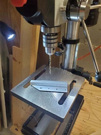

Brief Description:  Match and final drilled bulkhead and tie down to
I pulled out the VS to assemble the bulkhead and tie down bracket to it IOT final and match drill some holes. The plans also call for dimpling all the #30 holes in the bulkhead but there are two that shouldn't be dimpled since they sit under the tie down bracket.
Don't dimple
Don't dimple
Drilling tie down bracket
