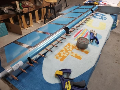

Brief Description:  Riveted trailing edge of both elevators
I used the special dies from Cleaveland to rivet the trailing edges of both elevators today. I may have countersunk the TE wedge a little too deep because when I set the rivets, the bottom edge pulled up slightly. It's not too bad but it was noticeable. That also could be because the shop head doesn't fill the dimpled skin as much as the manufactured head. We also rolled the leading edge of the left elevator and clecoed them in place.
Left elevator TE
Left elevator TE
Left elevator leading edge rolled and clecoed
