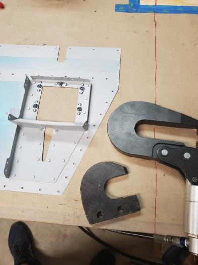

Brief Description:  Riveted ribs and trim access panels in place
Finished back riveting ribs to upper and lower skins. There is one rivet on the E-1008B ribs that the short back rivet set wouldn't reach and I didn't have the 12" one that Cleavelend sells so I used the 3x gun with the tungsten bucking bar. Mason worked the gun while I held the bar. It seemed to work fine but was a little slower.
Also riveted trim access panel pieces into place. I ended up using the squeezer for most rivets but I think it would've been easier to back rivet the reinforcement doubler (E-1410) in place then do the brace (E-1411) with the nutplates. The instructions were a little unclear to me on the order (except for the first two that need to be done before the brace is put in). I used two different yokes...the 4" one would reach the interior rivets and the 1.5" could fit in the access hole and do all of the ones in that area.
Trim access panel with Yokes used

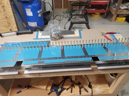

Left skins clecoed for rear spar riveting
