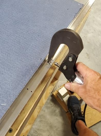

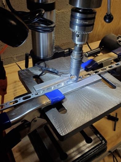

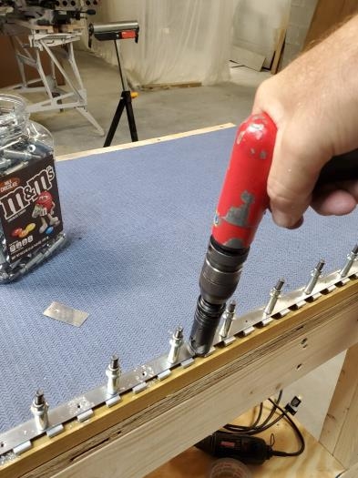

I finally got past Pg 9-09. It seemed to take a while to finish that page. Today was countersinking, dimpling and prepping parts for primer. I countersunk the TE wedges using the drill press, the trailing edge jig from Cleaveland and the modified countersink bit from Cleaveland. The bit comes in their -14 tool kit and already has the tapered pilot so using that bit with the jig allows for a flush countersink. I then clecoed the forward trim tab hinge in place on the rear spar and countersunk those holes using the air drill with the countersink cage tool. I clamped the rear spar to the workbench using a piece of wood and clamps. Once the holes corresponding to the hinge were done I used the Numatx squeezer to dimple all the rest of the holes in the rear spars. The yoke and die combination I used didn't require any modification as mentioned in the plans. It was a 3" yoke with a sub structure female dimple die. It went much quicker than using the DRDT. I then wiped down most of the pieces with MEK substitute in preparation for priming. Now that most all the skins and ribs are dimpled that will be next.
Countersinking trailing edges
Countersinking rear spar and TT hinge
Dimpling rear spar w/numatx squeezer
