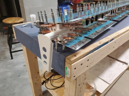

After taping a foam rib inside the trailing edge I clecoed the trailing edge in place in preparation for match drilling #30 the close out tabs. No issues here except the way I bent the close out tabs, they don't sit real flush with each other. I may have to manipulate this later to get a tighter fit.

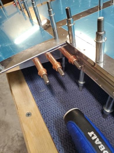

I also final drilled #30 the elevator horns to the front spar and ribs. The holes in the horns are 1/8 but the ribs and spar are 3/32.
Close out tabs match drilled
Elevator horns match drilled
