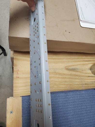

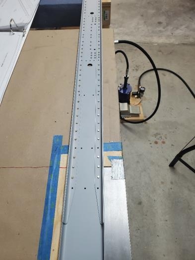

Brief Description:  Front spar riveting. Rib prep
Riveted front spar, doubler and caps together. Dimpled flange holes for nose ribs, inspar ribs. Take note not to dimple all the holes...indicated in Fig 1 (8-07) and all the small tabs.
Prepped HS peices for priming and sprayed 2 coats of SEM self etching primer.
Front spar, caps and doubler
Front spar
Front spar
