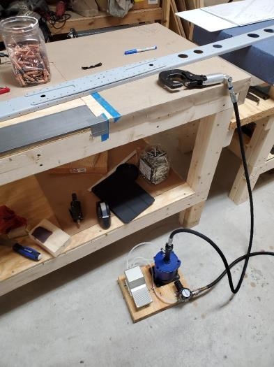

Brief Description:  Numatx Squeezer set up
I finally received my Numatx pneudraulic squeezer back from HyTech...for the second time. They decided to replace the entire unit, which they should've done the first time. It's only took 5 weeks to get it right.
I set up the tool, bled it and began riveting. It works really well once you figure out the pressures. Once the pressure is determined for the different diameter rivet (AD3 or AD4) the pressure stays the same no matter what the length of rivet is. I found that 43 psi works for the AD3's and 75 psi for the AD4's. I have 3 sections that are ready for riveting so this should go pretty quickly. I did some more prepping and priming too.
Numatx squeezer
Numatx squeezer
