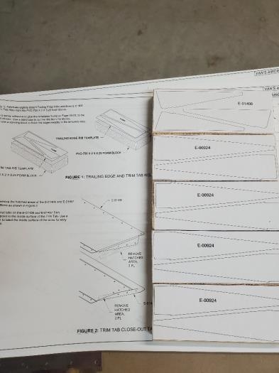

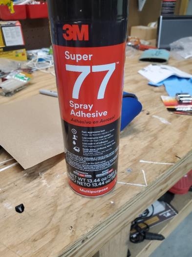

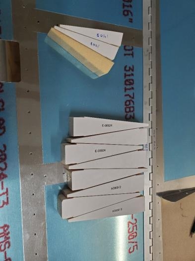

Continued work on smoothing the edges of the left skins then moved to fabricating the foam block ribs. I made a 1:1 copy of the cutouts of the foam ribs, cut them out and glued them to the foam blocks. I used 3M Super 77 spray adhesive. My bench sander has very fine sandpaper and was taking a while to final shape so I cut really close to the lines with the bandsaw. It's really easy to control the cuts so it went smoothly, then very fine tuning with the bench sander.
Glued to foam blocks
Bandsaw cuts
Bandsaw cuts
Spray adhesive
Spray adhesive
