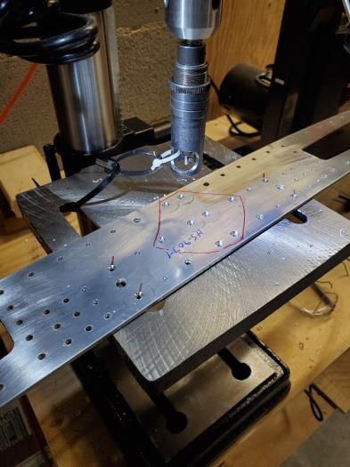

Brief Description:  Countersinking Front Spar Doubler
Countersunk the required holes in the front spar doubler. I used the drill press and some zip ties on the countersink cage to keep it from spinning. Small safety wire would probably work better but i didn't have any.
Front spar doubler countersinking
