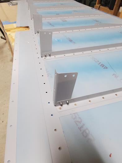

Brief Description:  Attached shear clips. Set one side of TE to skin.

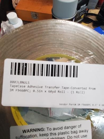

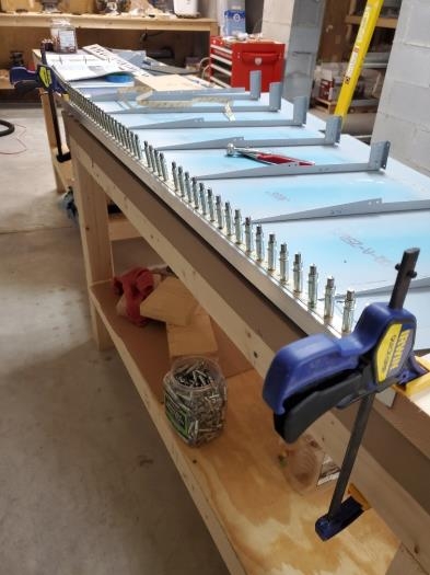

Today I attached the shear clips to the stiffners and the taped the TE to the skin then clecoed it in place to a 90 degree stock piece of aluminum. The aluminum had to be matched drilled prior. Before clecoing the TE edge in place, I applied a strip of double sided 1/2" 3M F9460PC VHB tape to one side. This stuff is really thin. I peeled off the opposite side and then set it in place and clecoed. I let it sit for a day.
Shear clips attached, LP4-3 rivets
3M VHB tape for trailing edge
TE clecoed to 90 degree aluminum stock
