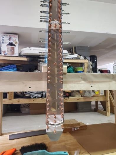

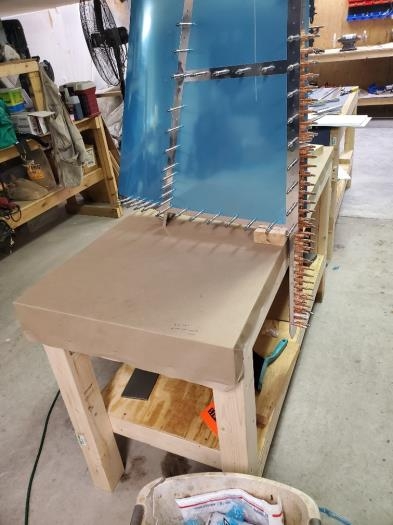

And so it begins. I pulled the parts for the VS. As with all sections, the iniial tasks involve smoothing all the edges. I used the 3M wheel on the bench grinder. There are also some pieces to cut. VS-01401 and VS-702 have to be trimmed and edges rounded. Once that is accomplished, the pieces are clecoed together for match and final drilling. Then everything gets taken apart, deburred and dimpled where appropriate.
