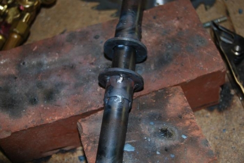

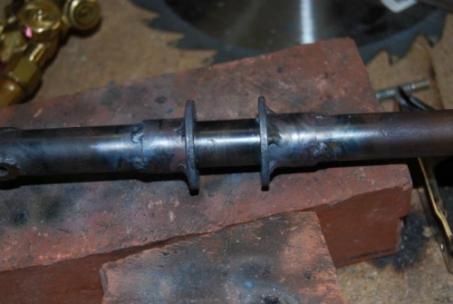

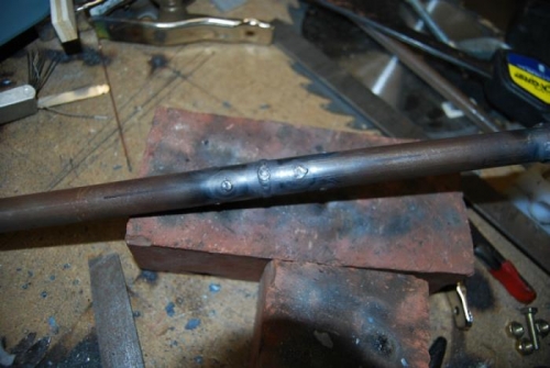

Brief Description:  Control stick assembly
I wasn't happy with the washers that act as stops for the rear bearing block. Cut off old washers and welded on new ones with tubing stops. Had to cut the control tube abd welded a sleeve back in with some rosettes. The welds on the tube stops were finished later when adding aileron stops.
