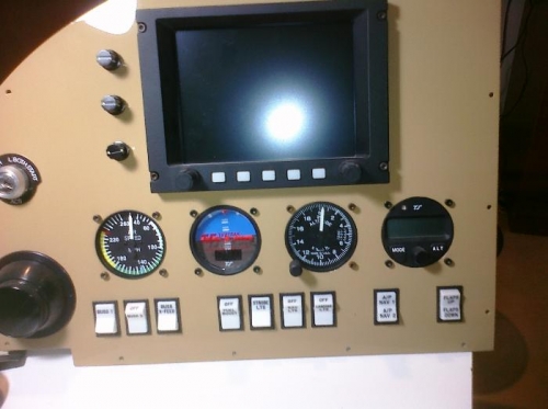

Honeywell rocker switches of various types are used for power, lights, autopilot and flaps.
The switches have LED lights controlled by aPerihelion dimmer to control brightness.
LH portion of panel

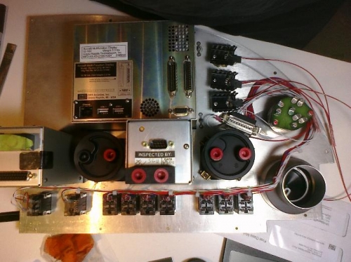

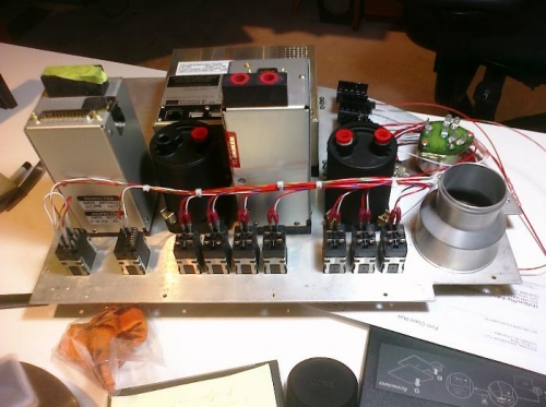

Only wiring for switch lighting is in place here
1 of 3 dimmers controls switch lighting - linked thru D-sub connector
