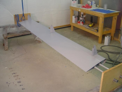

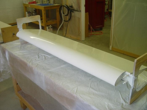

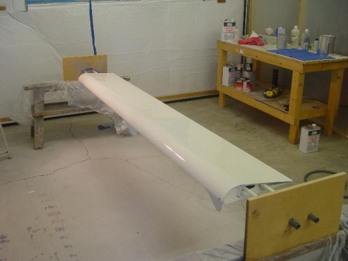

Brief Description:  Priming & painting aileron and flap
It all worked.
- had a light primer run on the leading edge of the flap. sanded and scotch brited it out before final
- had light coverage of leading edge on both flap and aileron with the final paint. Overcompensated for runs. It's just spray gun technique and I have litlle at this point but like everything else in this project, I'll be compentent jsut as I finish the last piece.
Unlike the wing, the leading edges here are mainly hidden so - we're gong with it. I could have waited 30 minutes and used some leftover paint to hit it again but didn't think of it at the time.
These 2 parts are done! 100% I hope.
All primed - blue strap allows 1 person flip
Flap painted and done!
Aileron painted and done
