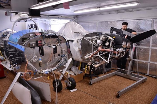

Engine off!
Engine off!

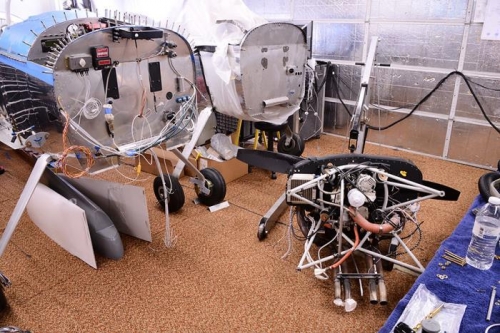

Engine awaiting a few last minute tweaks the the new fuselage.

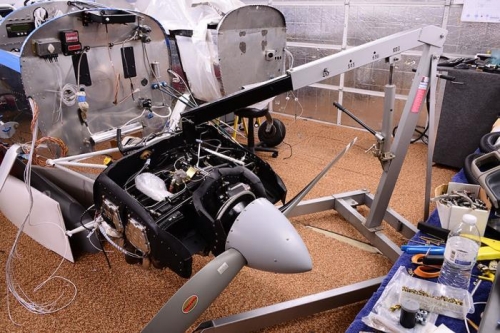

Engine going up on the new fuselage.
