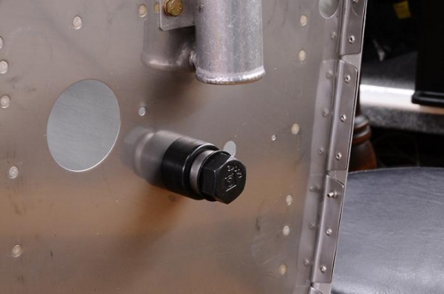

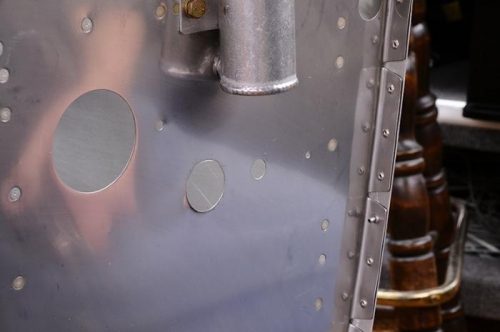

There are three small holes in the firewall that are designated as pilot holes for the Throttle Quadrant cables including the Throttle, Mixture, and Prop Control. I have these sweet eye-ball mounts for the firewall that allow the cables to gimbal around some reducing the stress on them in the high-vibration environment of the engine compartment. The problem is that they take exactly a 1 1/16" hole. On the first fuselage, I used a hole cutting saw in the drill, but the stainless steel is so hard that it really dulled the teeth fast and I ended up stretching the metal some in the process. This made the mounting of the gimbals a little loose and generally looked a little sloppy. This time around, I decided to just order a 1 1/16" Greenlee Chassis punch! It arrived today, so it was time to give it a try. Um, wow. Buy one. The holes just needed a little bit of deburring and the gimbals just dropped right in. Wow, what a difference in reduced labor and more importantly, a better over all installation (that's starting to become a theme!)
