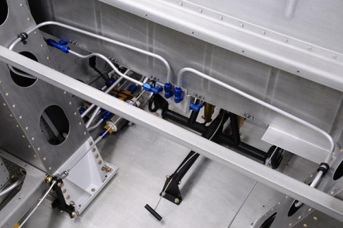

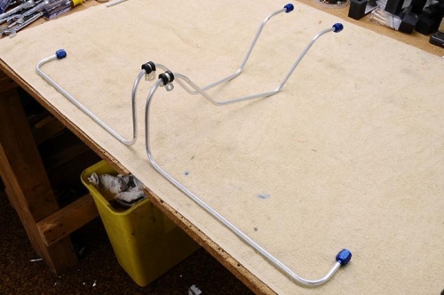

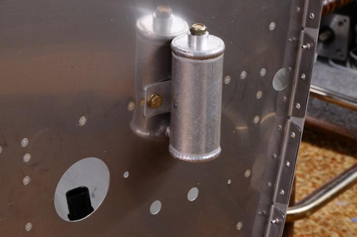

Next up was the brake lines. Since all of this stuff on the old fuselage still had brake fluid, I had to drain everything and then let it drip out over night. I removed all of the hoses and fittings and tubes and cleaned everything with lacquer thinner. I was per-usual dreading this job, but it turned out to be fairly straightforward without too much fuss or mess.

Brake Fluid Reservoir
New Set of Brake Line Tubes Custom Bent
Brake Lines
Brake Lines
