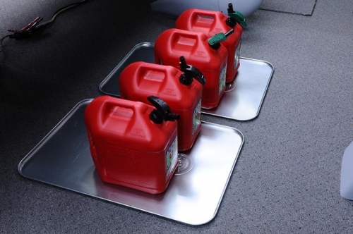

5.25 Gallons X 4 Containers

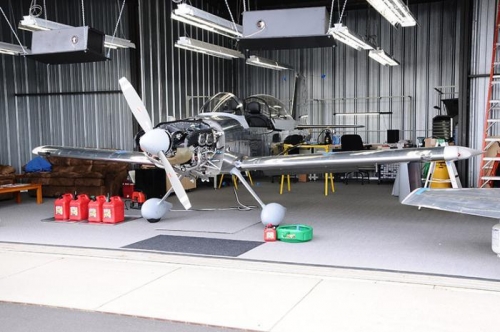

RV-8 In Flight Position
