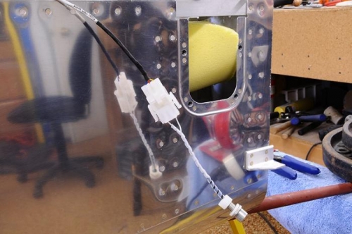

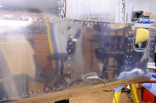

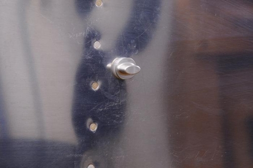

The EFIS's require an OAT probe for some of their calculations. I opted to mount this transducer under the Horizontal Stabilizer. The air should be fairly stable here (no heat from exhaust) as well as shielded from direct sunlight. Installation was straightforward. I added a connector, then realized later that the way I had installed it, I would have to cut the wire to replace it. Sheeze.

OAT Probe & Connector
OAT Mounted Under Stab
OAT Probe Close Up
OAT Probe Close Up
