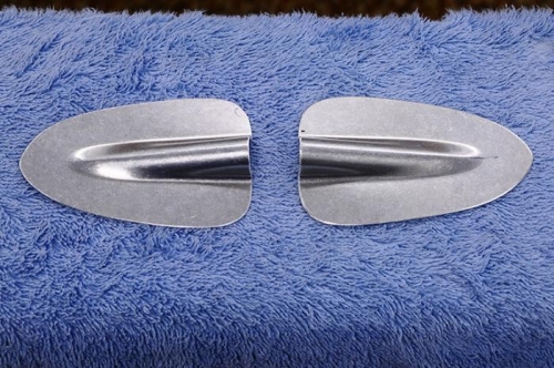

The rudder cables go from the rudder peddles up by the pilot's feet all the way down the inside of the fuselage and exit out under the horizontal stabilizer and then connect to the rudder horns. The stock setup would have you simply cut a hole on the side of the fuselage for the Nylon cable shields and call it done. I found a couple of preformed covers at Avery and added a touch of airfoil shape and riveted those bad boys on. Cools cool!

Airfoiled Avery Covers
