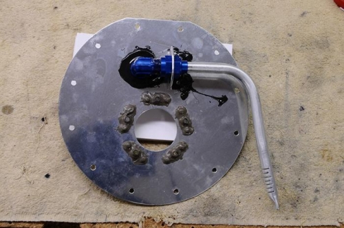

Right Fuel Cover With Pick Up Installed

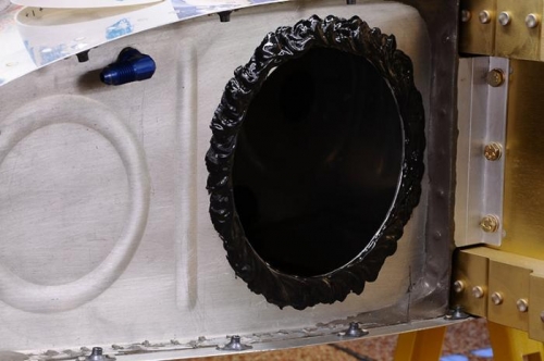

Right Gasket In Place With ProSeal

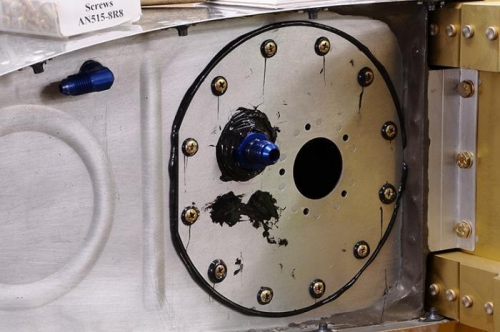

Right Cover Installed
