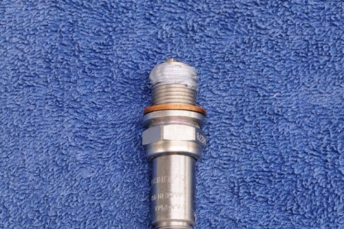

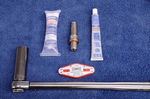

The first step was installing the eight spark plugs. I have a little tool specially designed for gapping aircraft spark plugs and so I gapped them all to .018". Once that was complete, I added some graphite-based, anti-seize compound to the threads of each spark plug, and then torqued them to 35 foot-pounds, making sure that I remembered to install the copper washer! The aircraft spark plugs take a 7/8" deep socket. I picked up a 1/2" drive socket to match the torque wrench I have and installation went fine. The 35 lbs torque seemed just right. That being said, I would have put them in a LOT tighter if left to my own devices. Good to read the manual.
