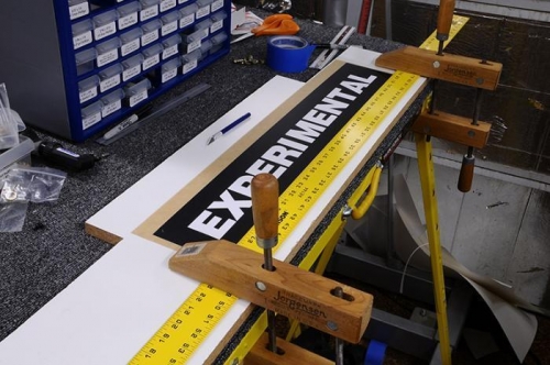

I had to come up with some sort of jig to mark and cut out the labels. The clamped straight edge worked out nicely. I trial fitted the side panels up onto the canopy frame to locate the labels and to see how they looked. Pretty cool, I think...
Jig For Cutting Label

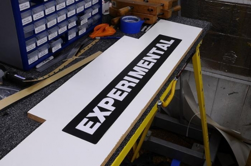

Label Cut
Label Cut

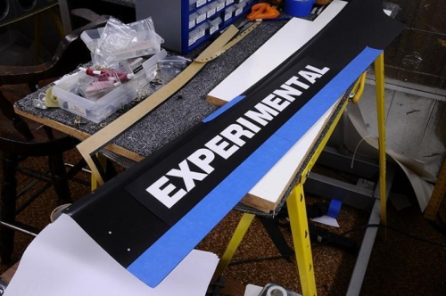

Blue Tape Marks Bottom Edge Of Label
