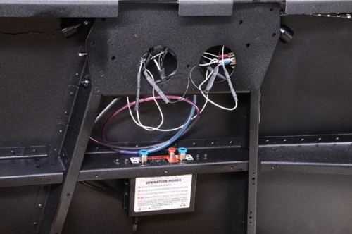

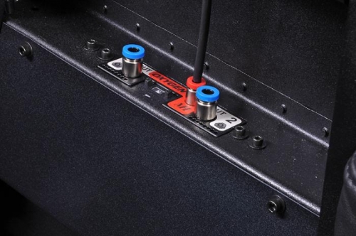

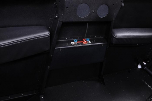

Brief Description:  Oxygen System EDS O2D2 Installation Complete
Final wiring and installation of the EDS O2D2 Pulse Distribution box for the Oxygen System and the associated wiring and supply hose went well. The black-on-black looks really awesome, I think! Its a pretty clean, custom panel mount installation for a box that's suppose to just be "portable" and not physically mounted.
EDS O2D2 & Cabin Wiring
