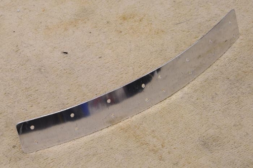

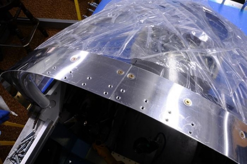

Where the left and right sides of the metal windscreen bezel formed a butt-joint, the skin was a little fragile so I decided to add a .032" stiffener on the underside just to make sure things were secure. This is an intuitive "hand-hold" area for pilot ingress and egress, so some additional support seemed paramount. Looks good and doesn't interfere with the rear canopy closure.
.032 Bezel Junction Stiffener
Bezel Junction Ready For Riveting
Bezel Junction Riveted - Top View
