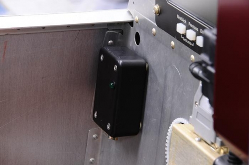

Oxygen System Controller - Mounted To Fuselage Bulkhead

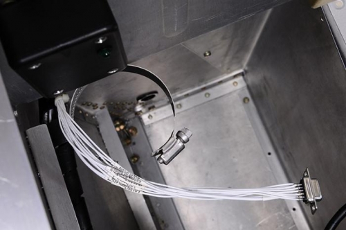

Oxygen System Controller - All System Wires Labeled & Terminated On Female HD DB15

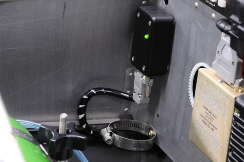

Oxygen System Controller - Wiring Complete, System Operational
