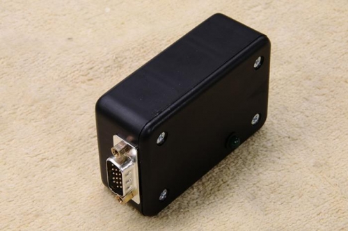

Once I had the circuit breadboarded, interfaced to all the various components, and debugged, I transferred the whole circuit to a matrix PC board. I cut the board to fit perfectly into the smallest plastic project box from Radio Shack, and then soldered all of the parts to the PC Board. I interconnected all of the various components using standard solid hook up wire, color coding the +5v connections in Red, Ground in Black, +12v in Yellow, and all signals in Green. Once the circuit was finished, I added a high-density DB15 connector, and then mounted everything into the project box.
Mounting the project box to the front baggage area fuselage bulkhead was pretty straight forward with the help of some #6 rivnuts and four rather long #6 screws that hold the lid on the box as well as the box to the bulkhead.

Oxygen System Controller - Project Box Complete
