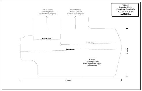

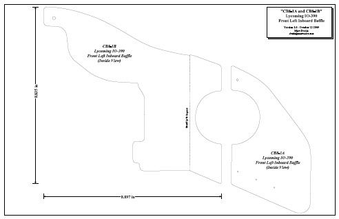

Brief Description:  Custom IO-390 Baffle Templates - Part 1
I have created CAD drawings of the custom baffle pieces I made for the IO-390 installation on the RV-8. Other builder's utilizing the IO-390 in their RV-8 or RV-7 should be able to use these templates to greatly speed up the baffling installation. Note that these templates also include the cut-down for the top cowling installation. Builders may want to leave the tops longer than the templates to assure they get a good fit to the cowling. Note that these are meant to be printed 1:1 on 11x17 paper. Be sure to use the reference dimensions in both the X and Y to verify that your printer is creating scale diagrams.
  • CB8-1A & CB8-1B - IO-390.pdf
  • CB8-2 - IO-390.pdf
  • CB8-10 - IO-390.pdf
  • CB8-11 - IO-390.pdf
  • CB8-20 - IO-390.pdf
  • CB8-5 - IO-390 - 063 Shadow Doubler For SW10610R Oil Cooler.pdf
  • Note: These pieces worked on my installation, but they may or may not work on others. No guarantees that they will fit any other installation.
    Drop me an email if you decide to use these templates and let me know how they worked!
