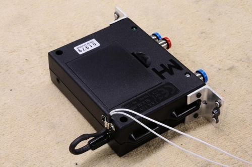

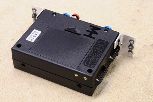

Brief Description:  Oxygen System - EDS O2D2 Power Cable Strain Relief
The oxygen system's Pulse Distribution module, the EDS O2D2, will accept either three AA batteries or an external power input that can be connected to the aircraft's electrical system (through a 4.7v regulator!). The problem I found was that the little power connector that plugs into the bottom of the O2D2 unit is kind of on the loose side. I added two more of the melt-in nut inserts and then supported the cable with a small cable strain relief. Works great!
