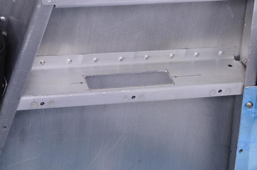

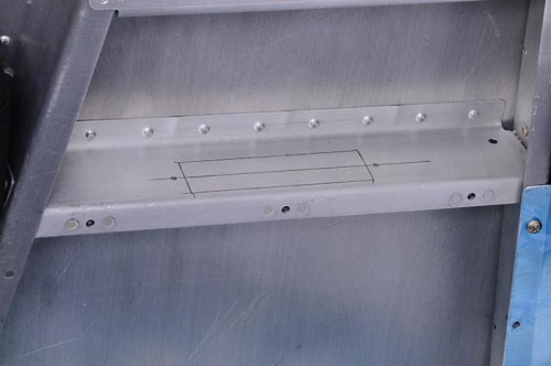

The first component to get mounted is the EDS O2D2 Pulse Demand System. The O2D2 is a very nice design and uses the inhale pressure from nose to momentarily turn on a burst of oxygen from the system. It kind of feels like a really faint puff of air. The beauty of this system is that it uses far less oxygen than traditional delivery systems that simply flow oxygen all the time.
The one down side to the O2D2 is that its meant to be a "portable" system and not panel mounted in anyway. My intention was to mount it along the right side of the cabin opposite the rear throttle quadrant. The problem was that there were no mounting ears or faceplate to speak of that could be considered a mounting solution.

EDS O2D2 Mounting - Fuselage Bulkhead Marked
EDS O2D2 Mounting - Fuselage Bulkhead Rough Cut
