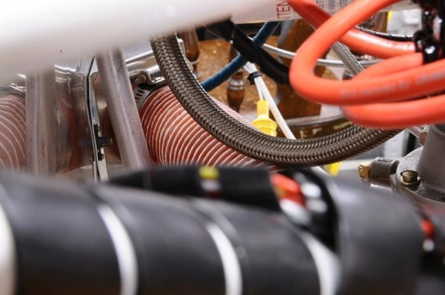

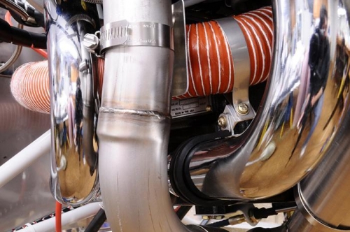

I also finally received the hardware bits I needed to finish the heater SCAT tubing support that is clamped over the #1 cylinder intake pipe. Also note from the photo that I attached a slick heat shield on the #1 exhaust pipe to protect the SCAT tubing from excessive heat transfer.
