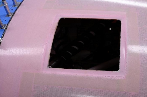

Rough Cut
Rough Cut

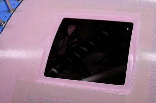

Filed Smooth
Filed Smooth

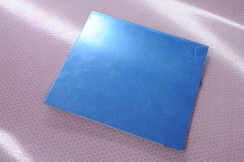

Initial Cut - .063 2024-T3 Oil Door
