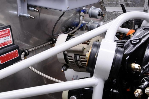

The oil pressure transducer for the RV-8 is a standard VDO, variable resistance unit and is mounted to the firewall. The oil temperature transducer is a special aircraft unit that screws directly into the back of the engine's accessory case. The wiring was already stubbed out to the firewall, so all I needed to do add connectors, labeling, and some spiral wrap to neat'n up the installation.
Oil Pressure Transducer and Line

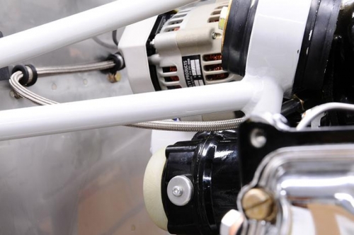

Oil Pressure Line From Engine To Transducer

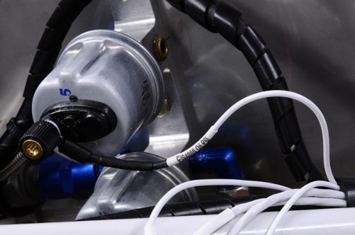

Oil Pressure Transducer Wiring
