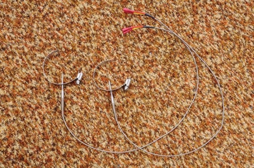

Brief Description:  EGT Probe Mounting - Part 1
The Exhaust Gas Temp (EGT) probes are put directly into the exhaust valve port by drilling a 1/8" hole about 1.5" down the exhaust pipe and inserting the probe directly into the flow. The probe is held in place using a special hose clamp. As with the CHT probes, there is one per cylinder so that the pilot can monitor all four temperatures at the same time for correct leaning procedures.
EGT Probes
EGT Probes
