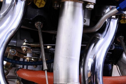

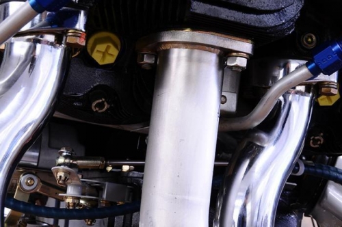

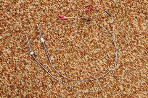

The Cylinder Head Temperature (CHT) is monitored by a probe that is plugged right into the bottom of the cylinder. The CHT probes screw into little bayonet fittings that are in turn screwed into special bosses on the bottom of each cylinder.
CHT Probes
CHT Probes
Bayonet Fittings Screwed In
CHT Probes Installed - Left Side
