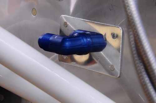

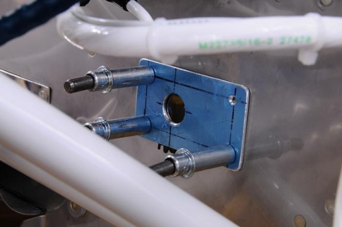

The fuel line installation is pretty straight forward. With the Van's Firewall-Forward Kit, all of the hoses are supplied already cut and terminated and firesleeves added. I had to add a firewall reinforcement plate that I had forgotten when I originally had installed the 3/8" blue AN fitting in the firewall and the Green Loctite really did its job at holding the bulkhead nut into place. Fortunately, I had a spare fitting as the original one was pretty thrashed by the time I got it out. Craig came over and gave me a hand with the riveting.
For the fuel line routing, there is a hose from the firewall AN fitting to the fuel pump, another from the fuel pump to the throttle body, and finally another one from the throttle body to the injector distributor on the top of the engine.

AN Fuel Fitting - Skin Stiffener
AN 3/8
AN 3/8" Fitting In Firewall
