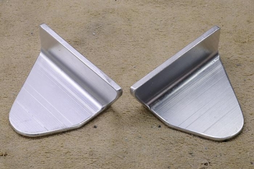

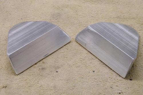

Friday, the replacement arrived and today I started in again on the project. I'm happy to report the both the left and right brackets came out perfect. I had a little trouble getting the bolts tighten because its too far to be able to reach both sides of the bolts at the same time, so I taped an end-wrench to the inside nut, braced against a fuselage longeron and was able to get all four bolts nice and tight with a fair amount of cussing. Next you have to drill the 1/4" bolt hole though the two brackets. You must maintain at least a 1/2" edge clearance all the way around the bolt on BOTH brackets. I drew up another little template and Scotch taped it to the front bracket similar to the way I did the rear spars. I started with a 1/8" drill and then used the 1/4" drill. I have to pull the wings off to finish adding the platenuts to the back side of the fuselage angle.
Overall, I'm very pleased with the bracket fabrication and installation.
Brackets Finish Filed

Brackets Finsih Filed
