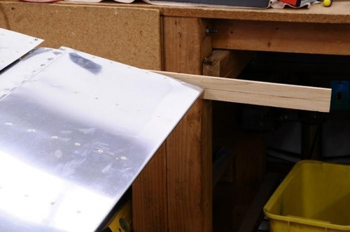

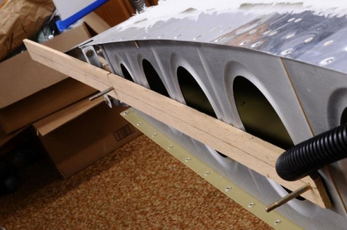

First you attached this little jig to each of the aileron bell cranks in the wing. This sets the neutral position of the bell crank and gives you a reference for neutral for the aileron. But then you have to make this little wooden jig to attach to the wing tip using the tooling holes in the end rib to find the exact neutral position for the aileron. Once these two are perfectly centered, you adjust the length of the short push rod between the bell crank and the aileron to the exact length necessary. Once this is done on both the left and right sides, you go into the cockpit and exactly center the control stick. Lastly, you adjust the lengths of the long aileron push rods so that the stick remains perfectly centered. Once that's done, your ailerons are perfectly rigged.
