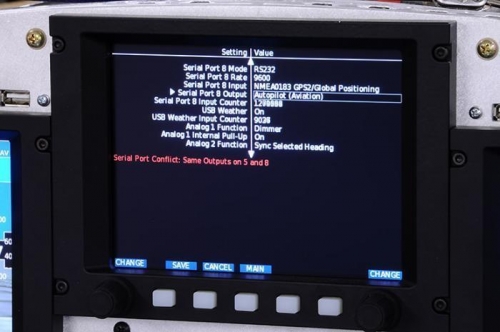

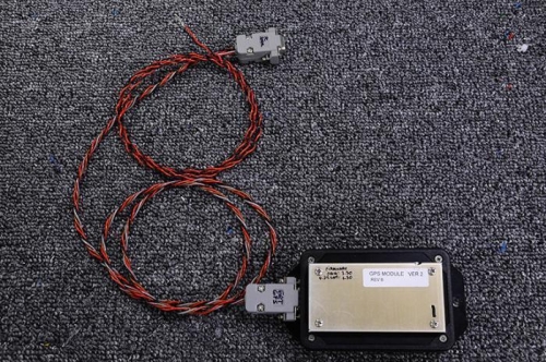

I built a special RS232-to-GRT GPS Module cable that also has a set of power leads for powering up the GPS. With this cable and the software downloaded from the Garmin web site as previously discussed, I was able to reprogram the module for 9600 baud (default was 4800).
HX Serial Port 5 Output - NMEA0183 Format
HX Serial Port 5 Output - Aviation Format
RS232 Cable To Configure GRT/Garmin GPS Module
