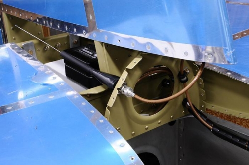

ELT Mounted and Wired Up
ELT Antenna Wiring (In Bundle) & Antenna Mounted
ELT Antenna Mounted
ELT Antenna Mounted
