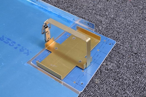

ELT Mounting Bracket & Latch Installed

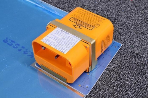

ELT Mounted
ELT Mounted

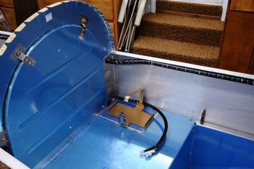

ELT Mount w/ Antenna & Control Wiring
