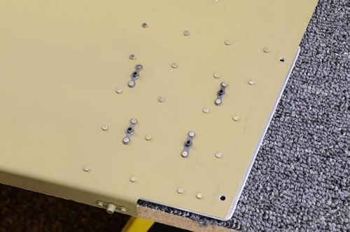

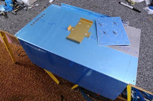

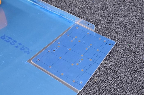

ELT Mount - .063
ELT Mount - .063" Skin Stiffener
Skin Stiffener Riveted On - Platenuts For Mouting
