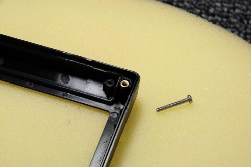

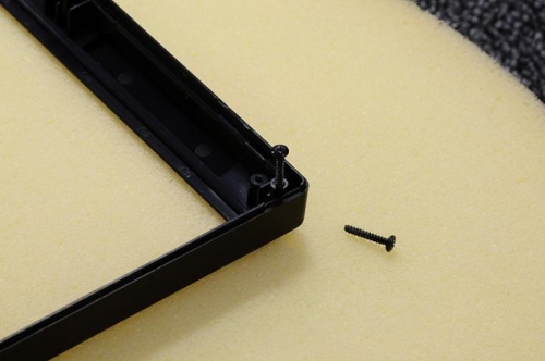

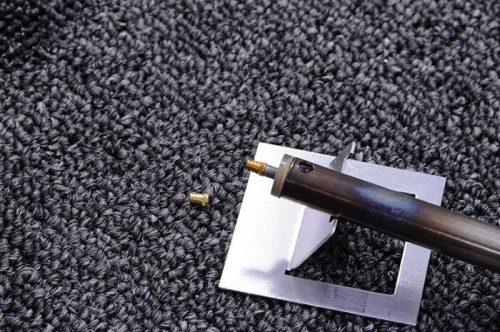

I was mentioning to Luke a couple of weeks ago that I was worried that the little self-tapping screws holding the front and back LCD cases together were going into plastic and I wasn't to sure that it was going to hold up long term. He mentioned that I should look for some metal nut-inserts that you can put into plastic using a special tip on a soldering iron. I found them in the McMaster-Carr catalog and ordered some. They went in pretty well actually, although the plastic posts were a little narrow for the 2/56 inserts. Nevertheless, they did go in and seem to be locked into place very nicely. Using the little 2/56 x .5" machine screws to screw the front and back LCD cases together works well and should hold up much better over time.
Original Self-Tapping Screws Into Plastic
Nut Inserts - Special Soldering Iron Tip
New 2-56 Machine Screw Insert
