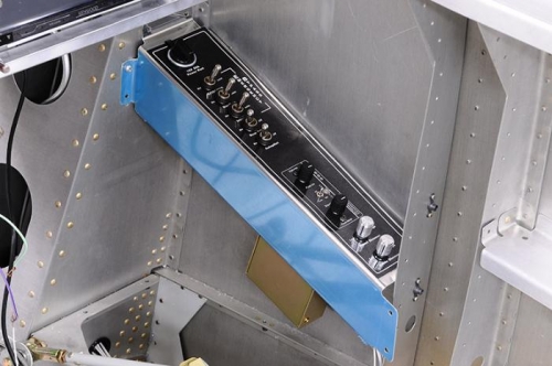

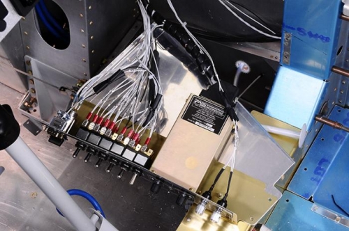

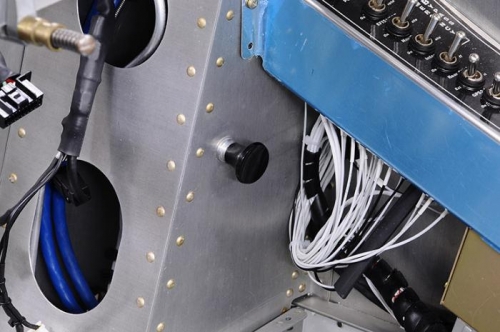

The right hand console has a bunch of wires connecting to the rocker switches and a huge wad of wires going to the PM3000 intercom. All of those wires and hardware hung down well below the bottom of the stock console side panel. After a fair amount of thought and planning, I came up with a slick implementation I think that hides all of the wires and hardware, yet is easy to remove and access the goodies as required down the road. Turned out that the DB25 connector for the Intercom actually hung down below the floor line and so I had to cut a rectangular hole in the floor skin to allow it to poke down. All-in-all the whole thing came out very nice in my opinion. The black knob is the heater vent lever, btw.
