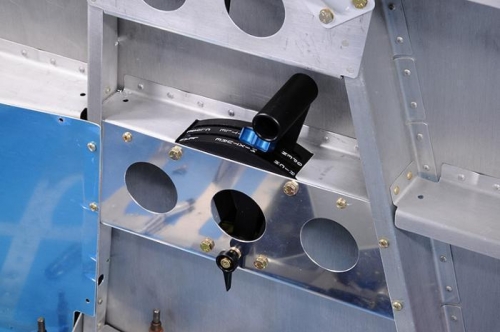

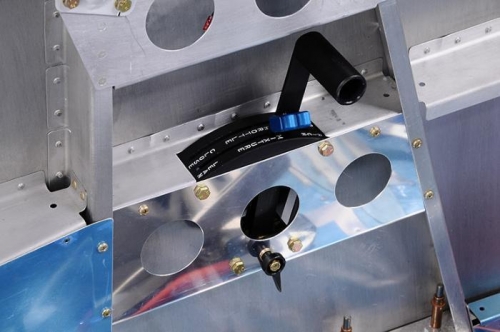

On the pilot's throttle quadrant, there are three levers instead of two. These include the Throttle, Mixture, and Prop Control. Since there isn't enough room in the back for all three, I opted for just two controls, the Throttle and Prop Control. Dayton Murdock, the friendly fellow than manufactures these quadrants, will custom make a special top plate with the Throttle/Prop labeling to replace the normal Throttle/Mixture. I spoke with him today and he will be making me a replacement plate and sending out in a week or so.

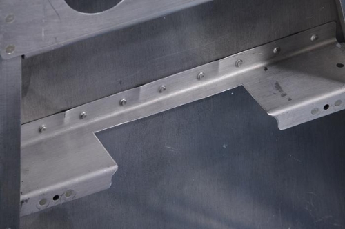

Left Fuselage Side Hole
Dual Quad Mounted For Rear Pilot
