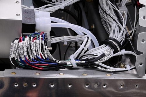

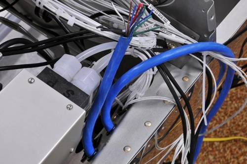

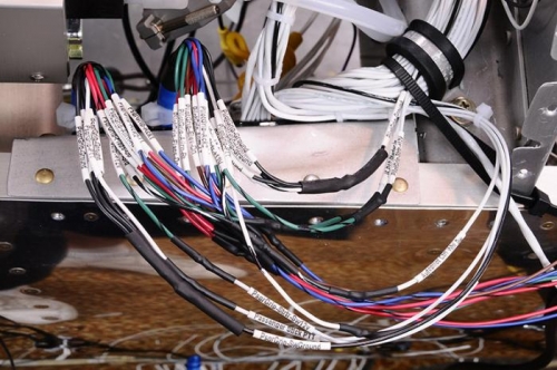

I labeled and terminated all of the front and rear stick grip wires behind the instrument panel. 6 wires went to the VP-200 to run the Flaps and Aileron & Elevator trim. The rest went to various places behind the panel. The Ground and +12 volts for the rear grip are switched through a toggle switch on the right hand console. This allows the pilot to completely disable the rear grip to avoid accidental operation of any of the buttons, for example when a non-pilot passenger is along.
Buttons on each stick include the following functions, all of which have been tested and are working:
* Engine Starter
* Flaps Up/Dn
* Elevator Trim Up/Dn
* Aileron Trim Rt/Lt
* Radio Push to Talk
* Autopilot Engage/Disengage
* VP-200/EFIS1/2/3 Acknowledge
* EFIS1/2/3 Page Flip
All in all it came out very nice and I'm quite pleased with the installation and operation.
Front & Rear Grip Unterminated Cables
Front & Rear Grip Cable Splices Done
Front and Rear Grips Wired
