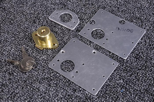

So back to the hardware store to find something a little slimmer. I found a snazzy cabinet and draw lock by "Security" part number U-9947 at Home Depot for about $5. It installs from the back which makes its lock barrel stick out instead of in which suited my needs perfectly.

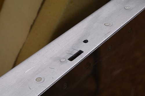

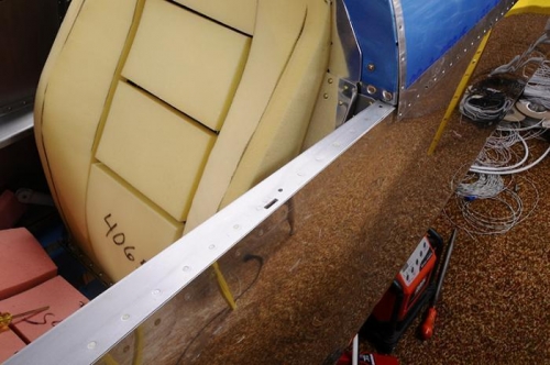

I spent the day fabricating a mounting system that ties nicely into the canopy frame with two screws and also rivets to the skirt. The lock tongue slides up and down, so I had to cut a perfectly rectangular hole in the slider rail and cockpit rail. It took about two hours to get the two rectangular holes cut perfectly so that the lock tongue slide in and out with no slop whatsoever!
The position of the lock is such that it holds the canopy very firmly in place even when you unlatch the regular latch and try to pull the canopy back. The canopy has to slide back about 2-3" before the rear slider will allow the canopy to pop up so a catch on the lock isn't needed.

Lock & .032 Stiffeners w/ .125
Lock & .032 Stiffeners w/ .125" Spacer
Canopy Rail Hole
Canopy Rail Hole
Canopy Rail Hole
Canopy Rail Hole
