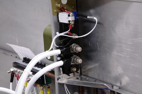

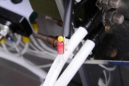

Brief Description:  Added a Polyfuse to Engage GPU Relay Button
Not having a fuse or breaker on the lead going to the GPU Engage button seemed like a bad idea. I added a 017 Polyfuse to the link which provides just enough current to pull the relay in.
017 Polyfuse in GPU Engage Button Link
Heat Shrinked and Installed
