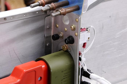

Brief Description:  Added A Button To Engage GPU Relay
I got a new high-current battery charger that is microprocessor controlled and is suppose to do a much better job of keeping the battery correctly charged when it is connected. After connecting it up to the RV-8 via the GPU (Ground Power Unit) plug, however, I discovered that the new charger wouldn't start charging until it saw at least 4 volts from the *battery* (this was confirmed by reading over the charger manual a couple of times). The GPU relay on my RV-8 is setup to activate from a +12 volt voltage coming from the *GPU*, so the new charger would never turn on. I added a small push button next to the GPU plug that now allows external activation of the GPU relay which enables the new charger to work correctly. Sweet.
GPU Engage Button on Left

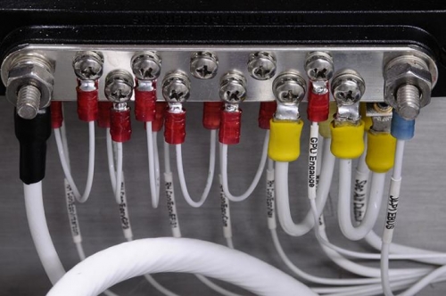

Button Connects to GPU Relay Input
Source of Power For GPU Button
