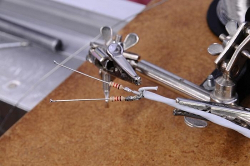

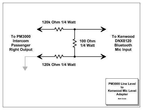

So I thought, I wonder if I could somehow hook up one of the PM3000 intercom's Passenger headphone outputs to the Mic input on the Kenwood...? I knew that it wouldn't work connecting straight up since the output from the Intercom was line-level (or greater) and the mic input was looking for a mic-level source. I got on the 'ol Interwebs and did some research into impedance matching circuits. I found this really cool web site on doing just that and they had a number of formulas you could use to calculate whatever you needed.
Impedance Matching Crcuit

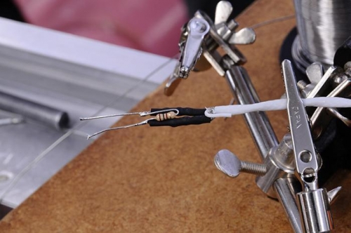

Adding Resistors To 1/8
Adding Resistors To 1/8" Jack End
